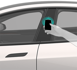

Some smartphones with NFC capability can be used to lock/unlock your vehicle, just like using a key card. Ensure the Tesla mobile app is correctly paired to your vehicle and enable the NFC function on your phone. Once enabled, simply hold the phone to the driver’s side door pillar to lock or unlock the door. Refer to your smartphone’s instructions for specific information on how to do this.

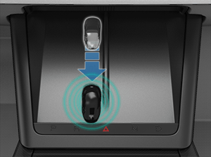

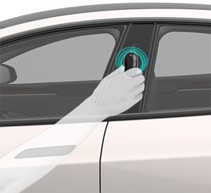

To use a key card to unlock or lock Model S, position the card as shown and tap it against the card reader located approximately one third the way up of the driver’s side door pillar. When Model S detects the key card, the exterior lights flash, the mirrors unfold or fold (if Fold Mirrors is on), the horn sounds (if Lock Confirmation Sound is on), and the doors unlock or lock.
PLEASE NOTE: You may need to physically touch the wireless phone charger or driver’s side door pillar with the key card, and you may need to hold it against the transmitter for one or two seconds.

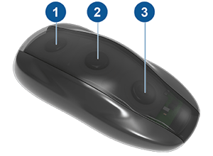

You can quickly familiarise yourself with the key fob by thinking of it as a miniature version of the Model S, with the Tesla badge representing the front. The key has buttons that feel like softer areas on the surface.
PLEASE NOTE: Depending on the market region, vehicle configuration, or date of manufacture, your vehicle may not come with a key fob. Go to http://shop.tesla.com for more information.
f434a20f-e8f9-4c17-934d-04568e3567f5
1) Rear trunk - Double-click to open or close the rear trunk. Hold down for one to two seconds to open the charge port door.
2) Lock/Unlock All - Single-click to lock doors and trunks (all doors and trunks must be closed). Double-click to unlock doors and trunks.
3) Front trunk - Double-click to unlatch the front trunk.
Once inside, power up Model S by pressing the brake pedal within two minutes of pressing the unlock button on the key fob (see Starting and Powering Off). If you wait longer than two minutes, you must press the unlock button again, or place the key fob near the card reader located in the lower half of the left wireless phone charger, facing downward, on the center console. When your key fob is detected, the two minute authentication period restarts.

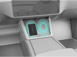

In the event that the key fob’s battery is dead, you can still use it. To unlock the vehicle, scan the key fob on the card reader located on the driver’s side door pillar (like the key card).
2bbc7b7e-e6fa-42d1-8ba0-df68cf22b728
To drive the vehicle, scan the key fob on the phone charger.
  1. Place it at the top of the left phone charger, against the center divider.
  2. Point the front of the key fob down.
  3. Swipe downwards.

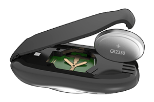

Replacing the Key Fob Battery
Under normal use, the key fob has a battery that lasts for up to one year, depending on key fob version and selected vehicle settings. When the battery is low, a message displays on the touchscreen.

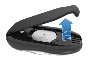

To replace the key fob battery:
1) With the key fob placed button side down on a soft surface, release the bottom cover, using a small flat-bladed tool.
2) Remove the battery by lifting it away from the retaining clips.
3) While avoiding touching the battery’s flat surfaces, insert the new battery (type CR2330) with the ‘+’ side facing up.
PLEASE NOTE: Wipe the battery clean before fitting and avoid touching the battery’s flat surfaces. Finger marks on the flat surfaces of the battery can reduce battery life.
CR2330 batteries can be purchased from any retailer that sells batteries.
4) Holding the bottom cover at an angle, align the tabs on the cover with the corresponding slots on the key fob, then press the cover firmly onto the key fob until it snaps into place.
5) Test that the key fob works by unlocking and locking Model S.

2) Scan your new key card or key fob on the card reader located on the wireless phone charger. To scan the key fob:
  • Place it at the top of the left phone charger, against the center divider.
  • Point the front of the key fob down.
  • Swipe downwards (as shown in the image).
When you hear a chime and the new key is recognised, remove it from the card reader.
