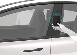

Some smartphones with NFC capability can be used to lock/unlock your vehicle, just like using a key card. Ensure the Tesla mobile app is correctly paired to your vehicle and enable the NFC function on your phone. Once enabled, simply hold the phone to the driver’s side door pillar to lock or unlock the door. Refer to your smartphone’s instructions for specific information on how to do this.

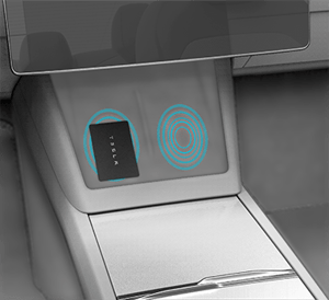

Key Card
Tesla provides you with two Model 3 key cards, designed to fit in your wallet.
To use a key card to unlock or lock Model 3, position the card as shown and tap it against the card reader located approximately one third the way up of the driver’s side door pillar. When Model 3 detects the key card, the exterior lights flash, the mirrors unfold or fold (if Fold Mirrors is on), the horn sounds (if Lock Confirmation Sound is on), and the doors unlock or lock.
PLEASE NOTE: You may need to physically touch the wireless phone charger or driver’s side door pillar with the key card, and you may need to hold it against the transmitter for one or two seconds.
faa97de5-e808-43c5-a923-4fbce6fee5cd
Once inside, power up Model 3 by pressing the brake pedal within two minutes of scanning the key card (see Starting and Powering Off). If you wait longer than two minutes, you must re-authenticate by placing the key card near the card reader located in the wireless phone charger on the center console. When your key card is detected, your two minute authentication period restarts.

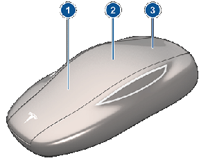

Key Fob
If you have purchased the key fob accessory, you can quickly familiarise yourself with this key by thinking of it as a miniature version of Model 3, with the Tesla badge representing the front. The key has three buttons that feel like softer areas on the surface.
3421f011-d689-491f-a4cc-8cefedc45fe8
  1. Front trunk - Double-click to unlatch the front trunk.
  2. Lock/Unlock All - Single-click to lock doors and trunks (all doors and trunks must be closed). Double-click to unlock doors and trunks.
  3. Rear trunk - Double-click to unlatch the rear trunk. Hold down for one to two seconds to open the charge port door.
Once inside, power up Model 3 by pressing the brake pedal within two minutes of pressing the unlock button on the key fob (see Model 3 Owner’s Manual). If you wait longer than two minutes, you must press the unlock button again, or place the key fob near the card reader located behind the cup holders on the center console. When your key fob is detected, the two minute authentication period restarts.
When approaching or leaving Model 3 carrying the key fob, you do not need to point the key fob at Model 3 as you press a button, but you must be within operating range.
Radio equipment on a similar frequency can affect the key. If this happens, move the key at least one foot (30 cm) away from other electronic devices (phones, laptops, etc.).
In the event that the key fob’s battery is dead, you can still use it to drive the vehicle by scanning the key fob on the card reader located on the driver’s side door pillar (like the key card).
Instructions for changing the battery are provided in Replacing the Key Fob Battery.
PLEASE NOTE: You can use the same key fob with multiple Model 3 vehicles provided you authenticate it (see Managing Keys). However, the key fob works with only one Model 3 at a time. Therefore, to use a key fob for a different Model 3, touch its flat side against the card reader on the driver’s side door pillar.
Model 3 supports up to four different key fobs.

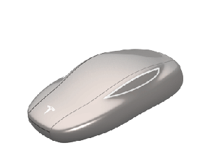

Under normal use, the accessory key fob has a battery that lasts for up to one year, depending on key fob version and selected vehicle settings. When the battery is low, a message displays on the touchscreen.
To replace the key fob battery:
1d762403-7757-4fa2-92f6-904266b3fb18
1) With the key fob placed button side down on a soft surface, release the bottom cover, using a small flat-bladed tool.
2) Remove the battery by lifting it away from the retaining clips.
3) While avoiding touching the battery’s flat surfaces, insert the new battery (type CR2032 ) with the ‘+’ side facing up.
PLEASE NOTE: Wipe the battery clean before fitting and avoid touching the battery’s flat surfaces. Finger marks on the flat surfaces of the battery can reduce battery life.
CR2032 batteries can be purchased from any retailer that sells batteries.
4) Holding the bottom cover at an angle, align the tabs on the cover with the corresponding slots on the key fob, then press the cover firmly onto the key fob until it snaps into place.
5) Test that the key fob works by unlocking and locking Model 3.
