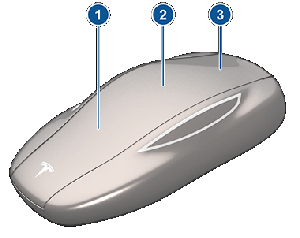

If you have purchased the key fob accessory, you can quickly familiarise yourself with this key by thinking of it as a miniature version of Model Y, with the Tesla badge representing the front. The key has three buttons that feel like softer areas on the surface.
967f0e50-6c7f-41dc-8bf9-8c29c2d6bda8
  1. Front trunk - Double-click to unlatch the front trunk.
  2. Lock/Unlock All - Single-click to lock doors and trunks (all doors and trunks must be closed). Double-click to unlock doors and trunks.
  3. Rear trunk - Double-click to unlatch the rear trunk. Hold down for one to two seconds to open the charge port door.
Once inside, power up Model Y by pressing the brake pedal within two minutes of pressing the unlock button on the key fob (see Starting and Powering Off). If you wait longer than two minutes, you must press the unlock button again, or place the key fob near the card reader located behind the cup holders on the center console. When your key fob is detected, the two minute authentication period restarts.

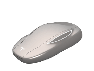

To replace the key fob battery:
2ba17b45-de6c-406e-acaa-285894fcc25e
1) With the key fob placed button side down on a soft surface, release the bottom cover, using a small flat-bladed tool.
2) Remove the battery by lifting it away from the retaining clips.
3) While avoiding touching the battery’s flat surfaces, insert the new battery (type CR2032 ) with the ‘+’ side facing up.
PLEASE NOTE: Wipe the battery clean before fitting and avoid touching the battery’s flat surfaces. Finger marks on the flat surfaces of the battery can reduce battery life.
CR2032 batteries can be purchased from any retailer that sells batteries.
4) Holding the bottom cover at an angle, align the tabs on the cover with the corresponding slots on the key fob, then press the cover firmly onto the key fob until it snaps into place.
5) Test that the key fob works by unlocking and locking Model Y.
